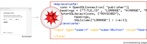

webMathematica allows a site to deliver HTML pages that are enhanced by the addition of Mathematica commands. When a request is made for one of these pages, the Mathematica commands are evaluated and the computed result is placed in the page. This is done with the standard Java templating mechanism, JavaServer Pages, making use of a special tags; examples of these are given in a later section.

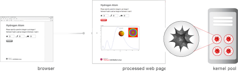

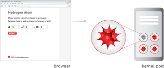

webMathematica provides a large library of Mathematica commands to handle the many possible ways of working with Mathematica computations. An important part of webMathematica is the kernel manager that calls Mathematica in a robust, efficient, and secure manner. The manager maintains a pool of one or more Mathematica kernels and, in this way, can process more than one request at a time. An overview of the workings of a webMathematica site is shown here.
1.  Browser sends request to webMathematica server.
2.  webMathematica server acquires Mathematica kernel from the pool.
3.  Mathematica kernel is initialized with input parameters, carries out calculations, and returns result to server.
4.  webMathematica server returns Mathematica kernel to the pool.
5.  webMathematica server returns result to browser.
