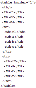

It takes a TableHeadings option, which works similarly to that of TableForm.
In[3]:=
Click for copyable input
Out[3]=

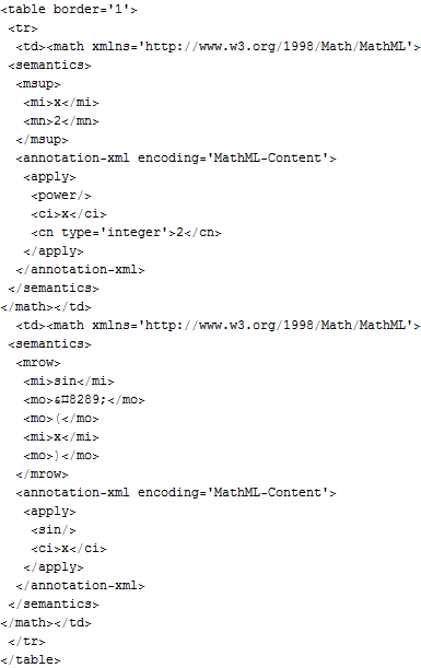

If you wish to apply special formatting to each element, you can provide a formatting function as a second element. The formatting function must return a string. Here every element is formatted into MathML.
In[4]:=
Out[4]=
