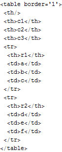

It takes a TableHeadings option that works similar to that of TableForm.
Out[3]= |  |

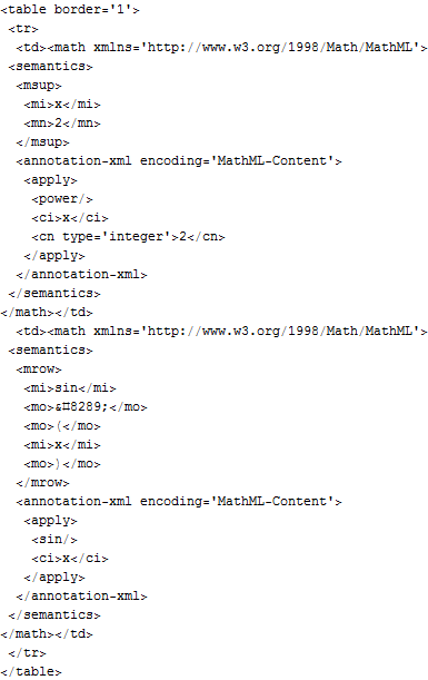

If you wish to apply special formatting to each element, you can provide a formatting function as a second element. The formatting function must return a string. Here every element is formatted into MathML.
Out[4]= |  |
