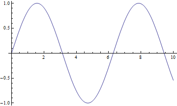

Plot Example
This example provides a web service that returns a plot of a function over a range. Note that if you had a toolkit for calling SOAP web services you could use that, but it is quite simple to use Mathematica, as is done here.
The source for this example can be found in the webMathematica web application in the directory Examples/WebServices/Plot.m (the full path in Tomcat would be webapps/webMathematica/Examples/WebServices/Plot.m). If your server is configured and running you can test this example from within Mathematica with the URL http://localhost:8080/webMathematica/Examples/WebServices/Plot.m?wsdl. (You may have some other URL for accessing your server.)
This installs the service and returns a list of Mathematica functions.
In[2]:= |
Out[2]= | ![]() |
This calls PlotString passing the argument Sin[x] as a string and the number 10. The result is a GIF bitmap of the image (returned as a list of bytes). A summary is shown in the following.
In[4]:= |
Out[5]//Short= | |
This turns the bytes into a string, and uses ImportString to display the image that was generated.
In[6]:= |
Out[6]= | ![]() |

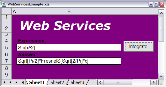

Excel Example
This example demonstrates how to call a Mathematica web service from Excel. The Mathematica code is Integrator.m, and the source can be found in the webMathematica web application in the directory Examples/WebServices/Plot.m (the full path in Tomcat would be webapps/webMathematica/Examples/WebServices/Plot.m). The Excel spreadsheet file, WebServicesExample.xls, can be found in the Extras directory in your webMathematica distribution.
This shows the implementation of the Integrator web service.

While it would be quite straightforward to call this with the Mathematica web services client, it is more interesting to use the Excel spreadsheet. The example, named WebServicesExample.xls, must be loaded into Excel. You need to allow macros to run, and then it looks something as shown below.
You enter an input into the Expression field, click the Integrate button and the result of the integration comes into the Answer field. If this does not work, you should check the URL that is used, which is written in the script that drives the example.
The actual work for this is done in a Visual Basic script that is included with the spreadsheet. While the documentation here does not include a detailed primer on programming in Visual Basic, it reviews the key elements of the script.

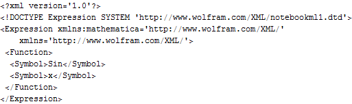

You can get an idea of the structure of the expression XML by exporting a general Mathematica expression. An example is shown below.
In[1]:= |
Out[1]= | ![]() |

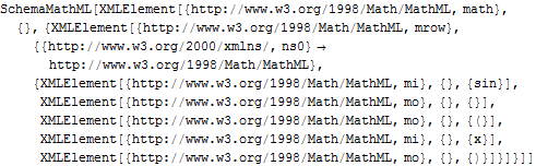

SchemaMathML
The SchemaMathML data type is used for transmitting MathML. Generally this is not so useful when Mathematica is the client. Typically it would be more useful with some other client.

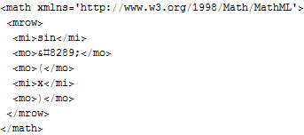

Mathematica has many functions for working with MathML. For example, the following generates a string of MathML.
In[1]:= |
Out[1]= | ![]() |

Another security issue arises from transmitting a string to the service. The string represents Mathematica input and it needs to be interpreted. The rule is that you should use MSPToExpression. This will use the webMathematica security system.
An example from the PlotString web service is shown below. Note how the command MSPToExpression is used.
PlotString[expr_String, limit_Integer] :=
Module[{e, result},
e = MSPToExpression[expr];
result = With[{var = Symbol["x"]}, Plot[e, {var, 0, limit}]];
SchemaBase64Binary[ToCharacterCode[ExportString[result, "GIF"]]]
ServiceReturn[PlotString] = _SchemaBase64Binary
This installs the Plot.m web service.
